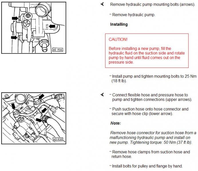

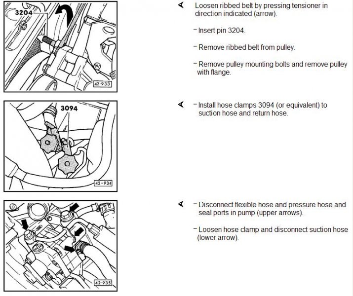

Before removing suction and pressure hoses from pump, install hose clamps, Snap-On Model YA2850 or equivalent, to suction and pressure hoses
Before installing hose on the suction side, fill pump with power steering fluid and turn by hand until fluid comes out of pressure side
5 - Pulley Remove to remove hydraulic pump, by loosening tension on ribbed belt AUDI-C4-SU02-48-012-01 Fig. 1

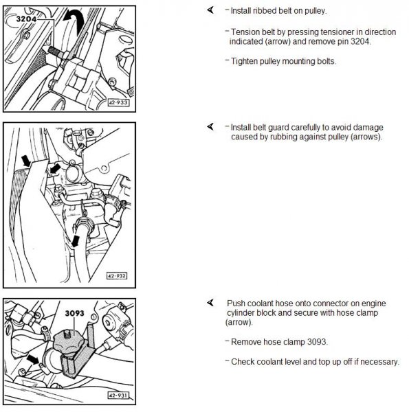

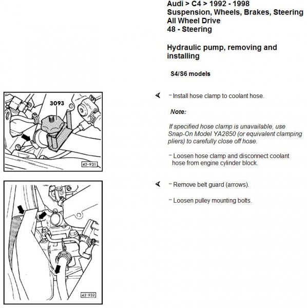

Fig. 1 Loosening ribbed belt
Remove ignition coils with bracket; remove upper pulley guard.
Turn open-end wrench in direction of arrow and install drift 3204.
Remove ribbed belt from pulley.
