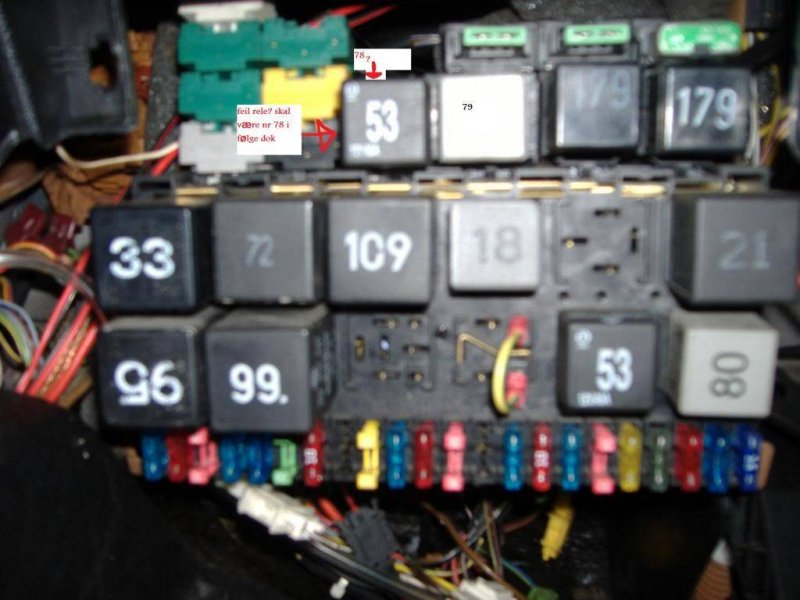

Abs virker ikke på min golf 3, kjøpte den slik. Har feilsøket litt og funnet ut at det mulig sitter feil rele`på ene abs rele`plassen. Sitter et rele`merker 53, men skal være et merkert 78. Funker 53 rele`likt eller kan dette være feilen ?DSCF1537mod.jpg
om det er noen med golf 3 vr6 som kunne tatt et bilde av sin sikringsboks, så hadde det vært supert. :)
ingen som kunne sjekket dette ?
ska ein tur opp i verkstaden i morgen. Skal eg ordne eit bilde.
Ser ut som det skulle vært en rekke til med rele'er her. : klø :

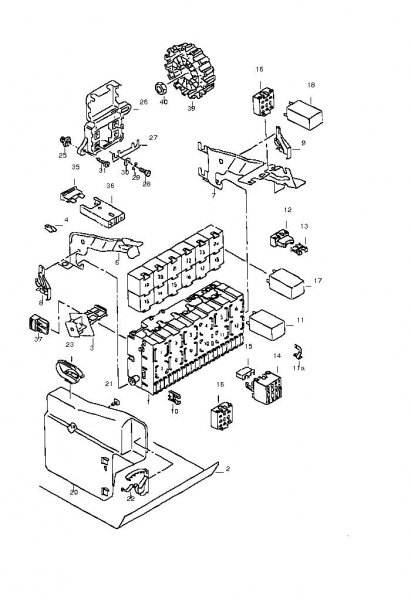

Noen rele'er med nr. og plassen de skal sitte.
(17) 141951253B relay / starter / relay location:13 / automatic: AAZ
(17) 171906383 relay / for intake manifold heating / relay location:13 / ABD,AAM,ABS,
(17) 357927181A relay - starter / 4 speed automatic gearbox / relay location/code no.:15/150 /
(17) 357927843A contact close relay / abs unit / relay location/code no.:16+17/179 /
(17) 191927841 relay / For ABS / relay location/code no.:18/79 /
(11) 1J0906381A relay / relay location:3 / AAA,1Z,AEY
(11) 7M0951253A contact close relay / for relief relay x contact / relay location:4 /
(11) 535957901 switch for speed warning indicator / relay location:5 "KSA","OM.", "KWT","BRN", "QAP","UAE"
(11) 1H0953227 turn signal/hazard light relay / relay location:12V 4X21W 6 /
(11) 431953231 turn signal/hazard light relay / for models with towing facility / relay location:
12V 6X21W 6 /
(11) 701955200 relay for headlight washer / relay location:7 /
(11) 191955531 control unit for intermittent wash-wipe automatic / relay location:8 /
(11) 3B0955531 control unit for adjustable wash-wipe automatic / relay location:8 /
(11) 3A0951307 buzzer / for lighting / relay location:9 /
(11) 1H0919433A warning time relay / for seat belt warning system without starter inhibitor / relay location:9 /
(11) 141951253B relay / for horn / relay location:11 /
(11) 191906383C contact close relay / for fuel pump / relay location:12 / AAA,ABS,ABD, AAM,ABF
(11) 141951253B relay / for lambda probe / relay location:13 / ABF,AAA
11A 823941817A plug bridge / for models with fog lamps and rear fog light / relay location:10 /
14 191937501 bracket for thermo switch / for models with electrically operated windows
