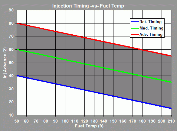

Setting Injection Timing:
The current Release of VAG-COM contains the TDI Timing Checker. See this page for more information.
This procedure does NOT apply to the PD engines!
Engine has to be warm (coolant above 85ºC)
Go to Engine Measuring Block 000
Switch to Basic Settings
Take note of the values in fields 2 (timing) and 9 (fuel temp)
Report in the following graph
Specification is within the shaded area between the blue and red lines
To slightly advance timing, you need to be in the upper portion of the shaded area.
Setting is done mechanically, slightly rotating the pump shaft once its three screws have been loosened.
It is strongly discouraged to set your timing outside of the specification!
Hvis du kjører med chip er bør du legge deg opp mot den røde linja, men ikke over! Skal ufattelig lite rotasjon på pumpa til for å få mye utslag på grafen.
