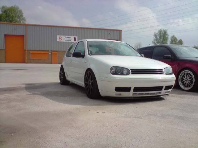

#9 Skrevet September 29, 2009 8x18" TT wheels et35 standard with 25mm spacers on the rearas, et10 18" Cargraphic 3 peice split rims in porsche fitment (quite a rare wheel, i have never seen a set the same in the uk) Fronts 18 x 8.5 with alloy outers, 215/40 tyres Rears 18 x 9.5 with stainless outers, 225/40 tyres 20mm H+R adaptors all round Tror bakfelgene har ET 47 eller 52 før adaptere 0 Del dette innlegget Lenke til innlegg Del på andre sider Flere delingsalternativer...
