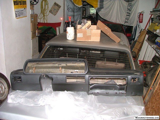

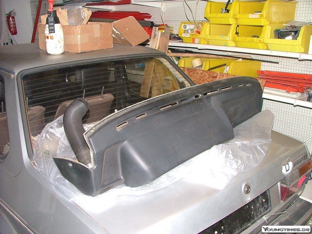

not much happened this weekend, but I picked up another part of the puzzle :
a well used dashboard for the passat; not perfect, but useable...
some small cracks, we'll see what to do. Don't want to spend 400 € for a brand new one (still available), so this is more than fine....
a lot of people doubt my sanity : smil : I am still enjoying it, so it can't be wrong ....

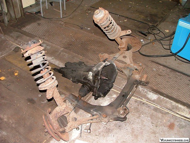

didn't do much this weekend (it was wifes weekend, repaired her car and the kitchen :P ) but this afternoon I escaped into the workshop and separated the engine from the gear box :
unfortunately no pics of how I did, don't want to get in trouble with health&safety :o
this is the rest, I am keeping the gear box and the subframe, everything else ill go into the bin....

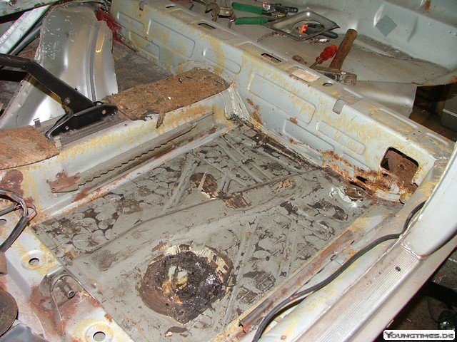

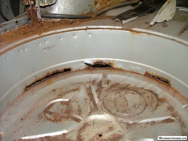

back to work; the spare wheel department :

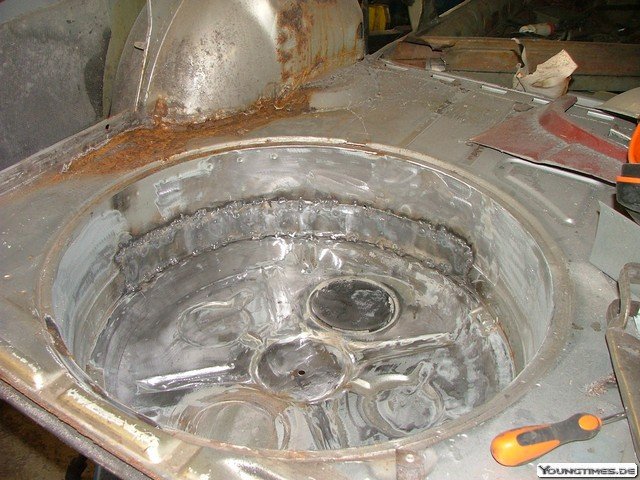

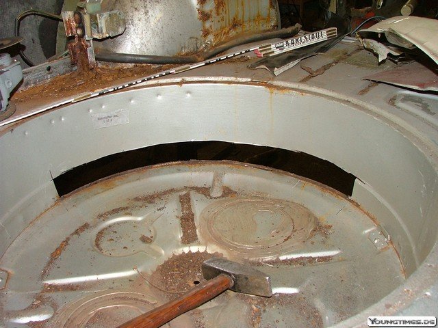

my initial plan was to cut out the spare wheel panel and use the part from the Jetta I have here.... I took a closer look and decided to patch it up, less work....

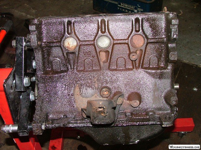

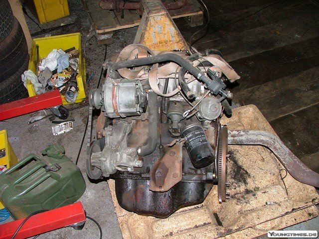

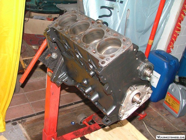

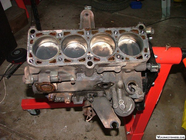

then I realised that today is not a day for welding.... and started to dismantle the engine. I had to put it onto the engine stand....
this was a job I really enjoyed today, no panel beating, welding etc. just simple work....
took of the head, no surprise here, the engine is the thing I worry the least at the moment, as they are absolute bullet proof....
I gave it a good clean and tomorrow i'll put some paint on it.... no modifications planned for the engine, as with 85 BHP it is quite quick (850 kgs) , I only want to replace the seals and update the cylinder head.... more pics tomorrow, probably I will be in the mood for a welding session : smil :
found some Hamerite in the workshop (satin black) and that's fine. Looks easy, but took a while to clean all the oil and dirt away....
Result, now it's time to find a gasket set on the bay..... next weekend it's welding time again... and also on friday we have a bank holiday ;)

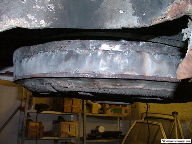

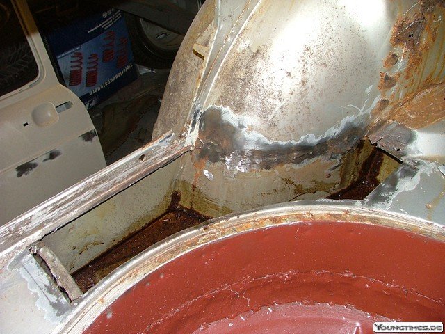

today we have a bank holiday over here, day of the german reunion, so I can use this day to do something useful :

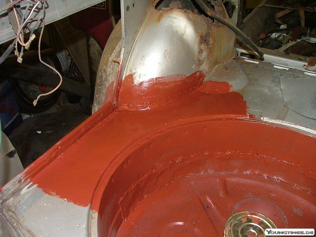

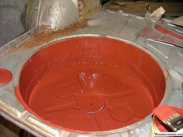

welded up the spare wheel department, could look better, but for me it is ok...
the rust was cut out, so that's ok...
some primer...
finished....

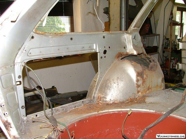

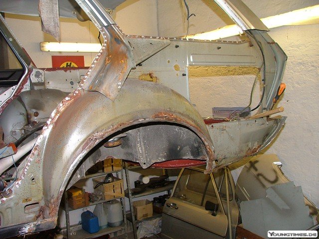

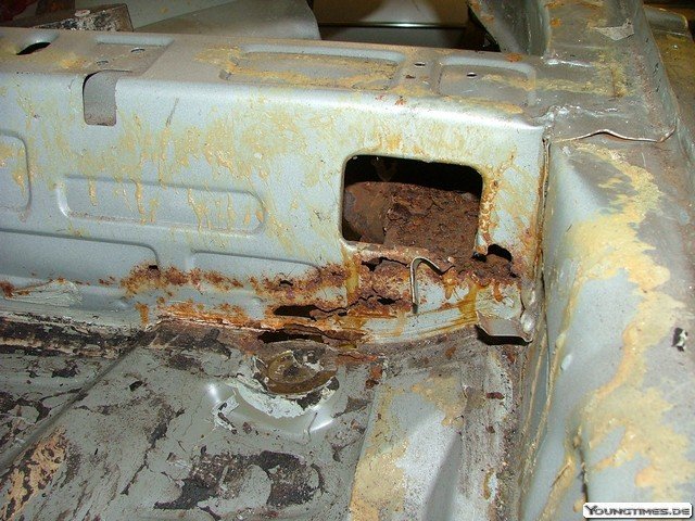

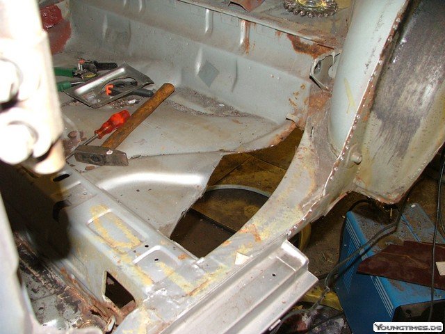

ok, I moved on to the left quarter panel... took out the grinder :
drilled the spots :
depsite of the huge hole it's actually better than the right side ...
and now I know, how the inner sill looks, there wasn't anything left on the other side 8-)
and here we go.... took an hour and it was gone...
trial fitting of the inner arch, perfect....

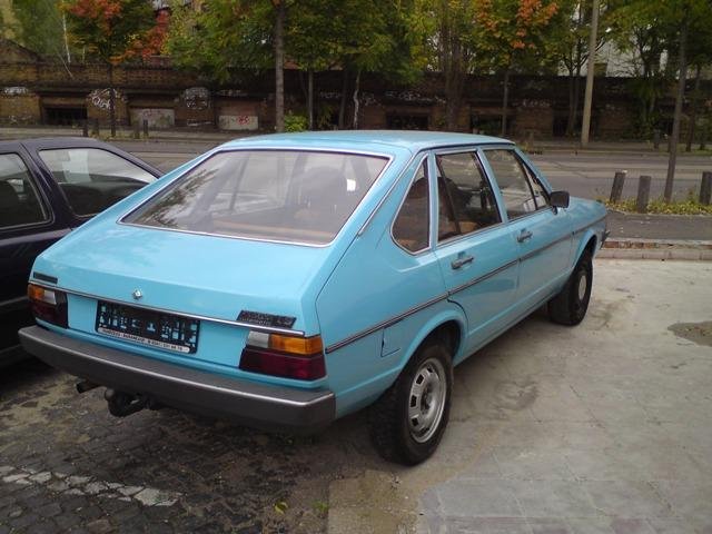

ah, I know I am not in a hurry to select the colour, but I have an idea.... the car was silver, not an option, so I thought white would be nice, then I found this :
this is miami-blue, a colour from the early Mk.I Golfs, it was available for the Passat , too and it was available with a blue interior.... should I go for this then ?

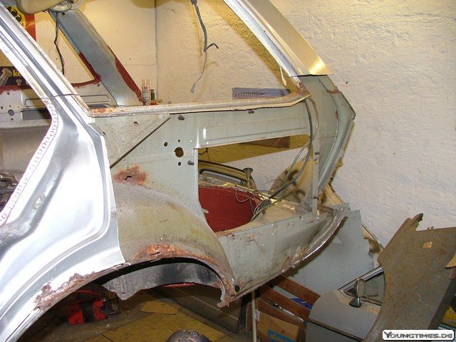

The rusty bit was the next thing to do. There was the tank for the rear windscreenwasher, this was obviously leaking a little bit and so the rust could start. Though the metal was solid , I decided to replace it....
cutting out was easy...

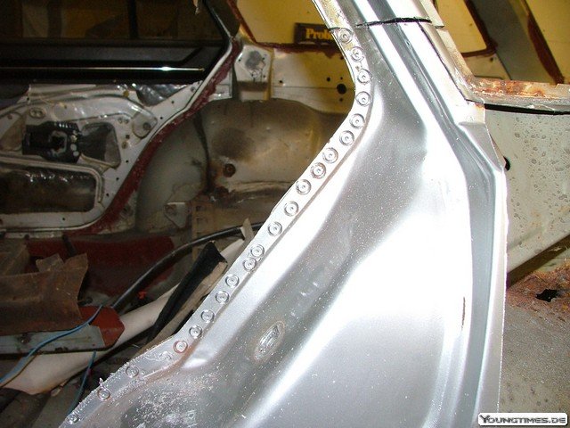

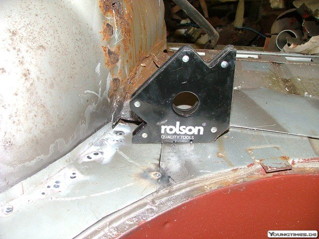

the panel was not too complicated to make, also I bought this magnet, which really helps when you want to put two panels together in one level or a certain angle...
in a true oldbus-style this is the finished panel ( I now only make fotos, when I have grinded down the welds and polished the surface).

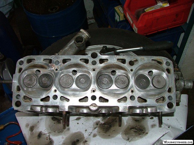

and I still had the chance to give the cylinder head a good clean. I'll bring this to a friend next week, who will replace the valve steams and adjust the valve clearance. I could do it myself, but I neither have the tools or the shims... it'll be quicker when someone else does it, I also ordered a gasket kit for the engine, so if I am bored or don't want to do any bodywork, I can put the engine back together....
those scratches by the bolt hole between the two cylinders on the left would worry me... just saying !
or are you getting the cylinder head re-faced?

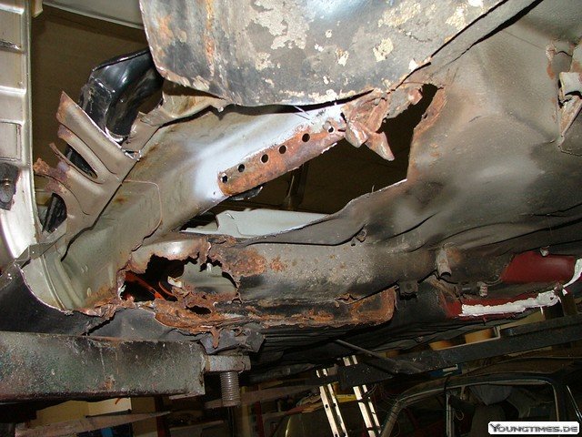

it's time for the weekly update; had to work yesterday, so I wasn't in the mood for working on the car, but today I escaped into the workshop after breakfast....

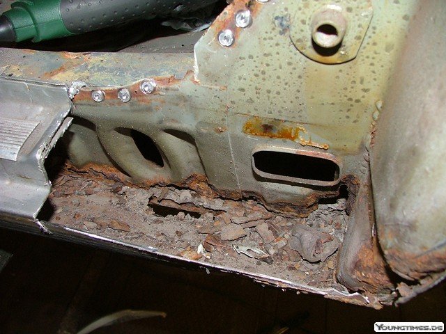

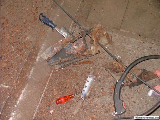

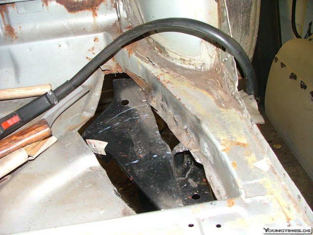

I ripped out the sound deadening, not a nice job, but as I have to weld there, the stuff must go out....

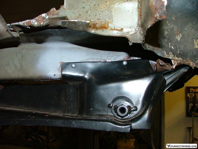

this is the part under the rear seat, where it meets the inner sill and the rear axle mount.... it is a bit complicated here, as I put one arm from the lift (Hebebühne?) under there, so I have to fix the mount before I can weld there...
so first I cut out the rear axle mount....
good bye....
looks scary, doesn't it ?

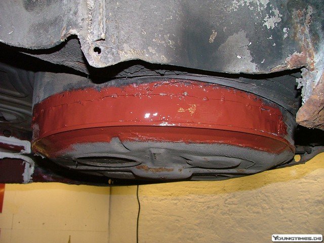

bolted the new mount on.... checked the measurements I made and then the welder came in place...
and finished with welding for today.... more next weekend....

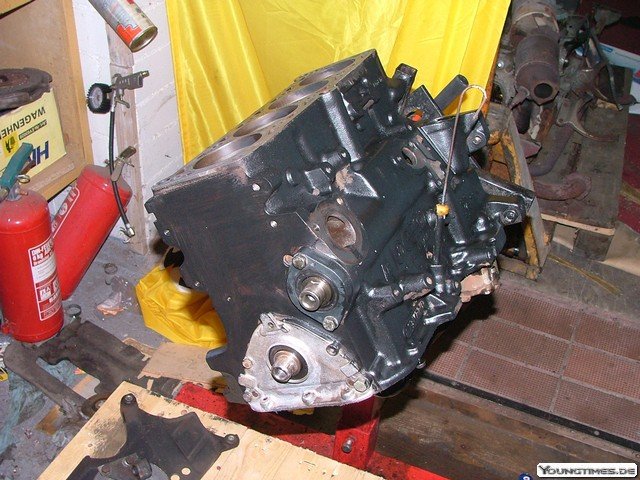

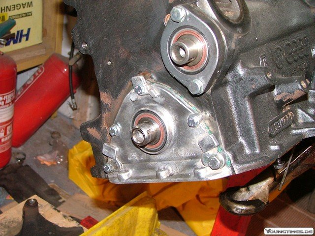

but I still wanted to do a bit, so off to the engine :

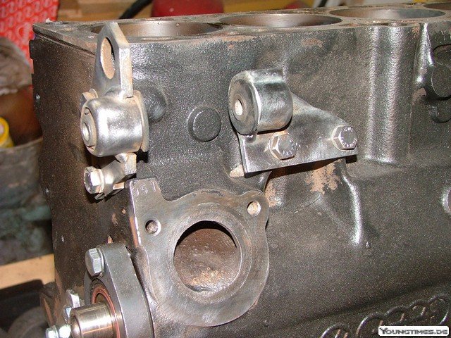

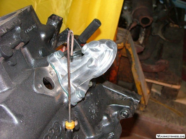

replaced the crankshaft and idler gaskets (and gave it a good clean with the wire brush...)
same with the mountings for the generator; this will receive some paint, but first the rubber mounts will be replaced, but they look shiney....
and the thing where the oilfilter is mounted.....
