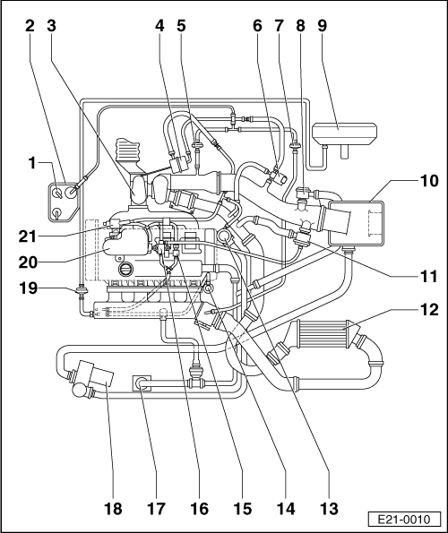

Her er "koblingskjema" over sullamitten:
1 - Breather pipe
q From gravity valve on fuel tank
2 - Activated charcoal filter
q With solenoid valve 1 for activated charcoal filter -N80-
3 - Turbocharger
4 - Pressure unit
q For charge pressure control valve
5 - Non-return valve
q For activated charcoal filter system
6 - Charge pressure regulation solenoid valve -N75-
q The valve will be activated from the engine control unit (pulsed)
7 - Non-return valve
q For brake servo
8 - Crankcase breather pressure regulating valve
9 - Brake servo
10 - Air cleaner with air mass meter (-G70-)
11 - Overrun shut-off valve
q Checking → Chapter
12 - Charge pressure sender -G31- charge air cooler
13 - Combi-valve
q For secondary air system
14 - Fuel pressure regulator
15 - Non-return valve
16 - Turbocharger divert valve -N249-
17 - Crankcase breather
18 - Secondary air pump motor (-V101-) */**
19 - Non-return valve
20 - Vacuum reservoir
21 - Secondary air inlet valve -N112-

Men om du ser på tegningen, så er da begge slangene koblet til en eller annen regulator?
Etter mine auge er det berre et skjøtestykke. Ikkje noken nummerert del.
Okei, så jeg skal bare fjerne skjøtestykket med andre ord?
Koble 13 rett til 21? :)
