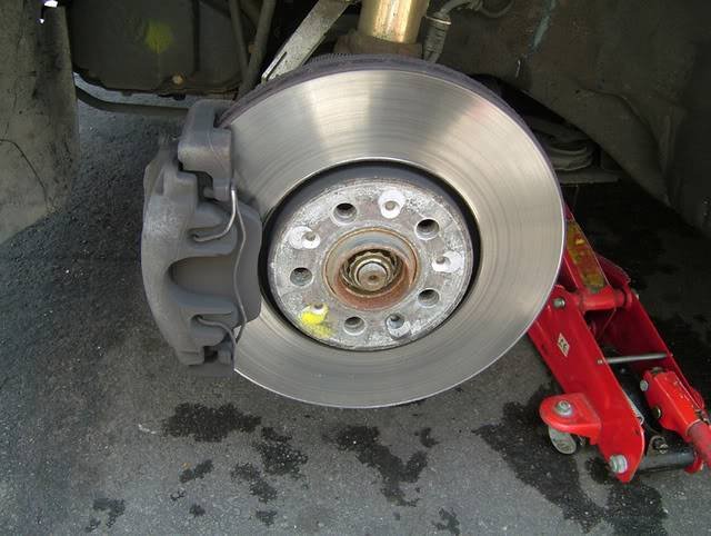

Most 75 to 122 HP Golfs come with the smaller FSIII brakes and 50 mm struts.
FN3 and FNRG front calipers > 55 mm strut.
It's so easy to recognize.
This 'FS-III' caliper > 50 mm struts:
This (Ate FN3) caliper > 55 mm struts:
