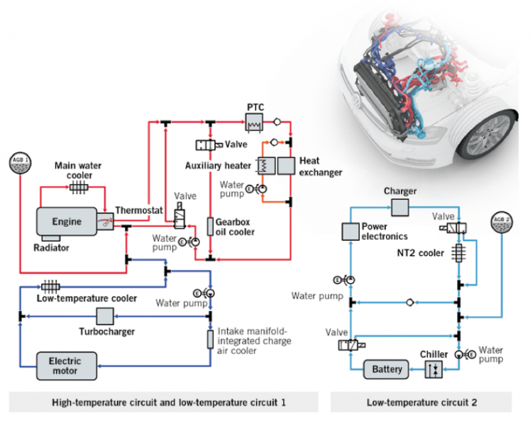

#13 Skrevet April 4, 2016 Her er litt om varme/kjølekretser i e-tron/GTE: Thermal management The plug-in hybrid uses a three-circuit cooling system: one high-temperature circuit and two low-temperature circuits. The high-temperature circuit handles the engine; the integrated gearbox oil cooler can be shut off on the water side, enabling the gearbox to be both heated and cooled. In electric driving mode the interior is heated by the high-voltage auxiliary heater (PTC). Heat sinks (cold gearbox, cold combustion engine) can be disabled in EV mode by means of bypass lines to provide rapid system response and high levels of air-conditioning comfort. Low-temperature (LT) circuit 1 conditions components with an average operating temperature of 75 to 90 °C, such as the charge air cooler of the engine and the electric motor. LT circuit 2 handles power electronics, charger and high-voltage battery; these three components can be cooled according to demand, both passively by the LT cooler and actively via the air-conditioning circuit, which is connected to the LT circuit 2 via a chiller. LT circuit 2 can additionally be divided into two sub-circuits, enabling different temperature requirements of the various components to be met. Kilde: http://www.greencarcongress.com/2014/04/20140403-mqbphev.html 0 Del dette innlegget Lenke til innlegg Del på andre sider Flere delingsalternativer...

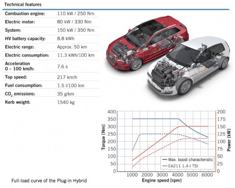

#19 Skrevet April 4, 2016 Interessant diagram. Om jeg forstår det rett så er de hele linjene systemeffekt/systemdreiemoment for E+B, mens de stiplede er for B alene. Forskjellen mellom de to er da det som elmotoren yter? (eksempelvis 100 Nm i normalt bruksområde). Og for effekten så gir elmotoren ca 25kW i lavere turtallsområde og øker til 40kW - dvs at man aldri tar ut max el-effekt i "boost" (kun 40 av 80 kW). I så fall stemmer ikke det du sier om at det alltid er de 80kW/102HK som benyttes først, og "toppes" med bensin? Eller er stiplede linjer for en tradisjonell 14TSI150, dvs at figuren ikke sier noe om hvordan hvor mye E og B som skaper systemverdiene for hybrid (E+B)? (Dvs at det kan være 80kW fra elmotoren i boost mode?). Og trolig er det DSG'en som gjør at max Nm er 350, ellers kunne det vært mer? 0 Del dette innlegget Lenke til innlegg Del på andre sider Flere delingsalternativer...
#20 Skrevet April 5, 2016 (endret) Men hvordan er det da med "vanlige" folk i "vanlige" hybrider (les: Prius). Det går jo et sekssifret antall av disse i statene, og de fleste bilfolk er ikke veldig begeistret for denne modellen, noe som igjen skulle tilsi at mange av de som kjører slike biler bare ser på den som en bruksgjenstand, og dermed kjører som om det skulle være en gammmel Corolla... Jeg googlet litt, men fant bare tips om hvordan få motoren til å varme seg opp fortere, og at det virker som om både Ford, Honda og Toyota har turtallsperre rundt 3500-4000 rpm for å begrense turtallet på kald motor. Ellers fant jeg ikke mye om temaet. Jeg ser, de gangene jeg kjører igang med kald motor, så er turtallet begrenset - ved normalt pådrag på Prius +'n min. Bensinmotoren går på "tomgang" (rundt 1000rpm-ish), mens elmotoren skyver bilen fremover. Når farta øker, fra 40kmt-ish, så begynner bensinmotoren å øke turtallet - for mer kraft. Det er aldri noe skrikende turtallsmaskin i en Prius uansett. Koblet til en OBDII-leser, og max rpm jeg fikk var rundt 4600rpm. Varm motor og full pedal. Prøvekjørt en Passat GTE. Den hadde liknende system, som Priusn. Er det minusgrader ute (som det var da jeg lånte en), så starter man på "hybrid"-modus uansett, for å få opp tempen i systemet. Når alt er oppe i driftstemp, så funker GTE'n som en "normal" hybrid. Evt. så setter man den i EV, og kjører den elektrisk resten av turen. På langturer, så fant jeg ut at det er like greit å ha GTE'n i hybridmodus. Målte 4,9l/100km på 69 kjørte km, 1t 12min med snittfart på 57kmt i -3 grader. Kjørte økonomiskt. El drift til det var tomt, og hybrid resten av veien. I bilen: meg, fruen, begge barna våre (2år, 7mnd) og helge-tur oppakning u/barnevogn. Hjemturen dagen etter, med fullastet bil (samme som dagen før + 5 flytteesker), målte jeg: 6,1l/100km på 84km, 1t 31min med snittfart på 56kmt i -5 grader. Da brukte jeg mest hybrid modusen. Prøvde også charge modusen, for å se hvor fort den lader opp batteriet igjen. Passat GTE: Meget imponerende hybridbil! Vurderte den som neste drosjebil, men ble vraket - blir 4x4 på neste drosjebil. EDIT: Legger ved bilder.... 0 Del dette innlegget Lenke til innlegg Del på andre sider Flere delingsalternativer...
#21 Skrevet April 6, 2016 Interessant diagram. Om jeg forstår det rett så er de hele linjene systemeffekt/systemdreiemoment for E+B, mens de stiplede er for B alene. Forskjellen mellom de to er da det som elmotoren yter? (eksempelvis 100 Nm i normalt bruksområde). Og for effekten så gir elmotoren ca 25kW i lavere turtallsområde og øker til 40kW - dvs at man aldri tar ut max el-effekt i "boost" (kun 40 av 80 kW). I så fall stemmer ikke det du sier om at det alltid er de 80kW/102HK som benyttes først, og "toppes" med bensin? Eller er stiplede linjer for en tradisjonell 14TSI150, dvs at figuren ikke sier noe om hvordan hvor mye E og B som skaper systemverdiene for hybrid (E+B)? (Dvs at det kan være 80kW fra elmotoren i boost mode?). Og trolig er det DSG'en som gjør at max Nm er 350, ellers kunne det vært mer? Jeg forstår det slik at den stiplede linjen kun forteller om ytelsen til bensinmotoren alene, men at diagrammet egentlig ikke sier noe om hvor mye som brukes av "hva"... Mulig jeg tolker det feil.. 0 Del dette innlegget Lenke til innlegg Del på andre sider Flere delingsalternativer...
