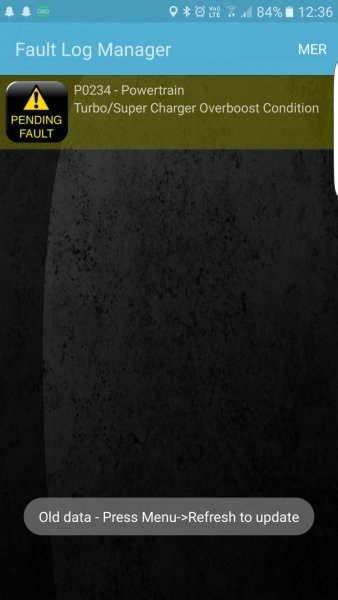

#1 Skrevet Mars 11, 2017 Hei har fått en feilmelding på turboen min. Er en vw passat 2l 4x4 07 mod. Noen som kan hjelpe. Bilen kutter turboen på 3500 omdreininger. Må jeg ha ny turbo eller er det noe annet. Takk på forhånd 0 Del dette innlegget Lenke til innlegg Del på andre sider Flere delingsalternativer...

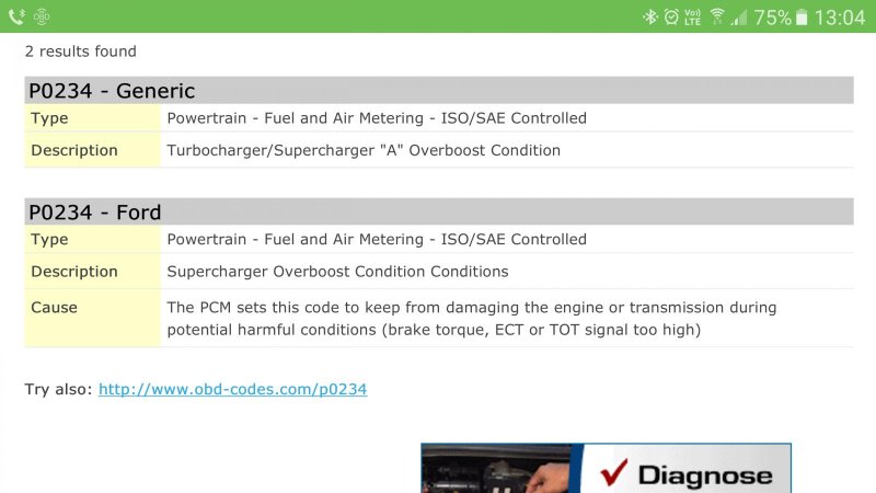

#2 Skrevet Mars 11, 2017 Her er det noen tips. Sakset fra Rosstech. 16618/P0234/000564 - Boost Pressure Regulation: Limit Exceeded (Overboost Condition) Possible Symptoms Malfunction Indicator Light (MIL) ON Boost Pressure too high Reduced Power Output Possible Causes Hoses incorrectly connected, disconnected, blocked or leaking Boost Pressure Control Valve (N75) faulty Boost Pressure Sensor (G31) faulty Turbo Charger stuck/faulty Possible Solutions Check Charge Pressure Control System Perform Output Test (to check the Turbo Charger) Perform Basic Setting (to check the Charge Pressure Control) Perform Pressure Test to locate Leaks Check/Replace Boost Pressure Control Valve (N75) Check/Replace Boost Pressure Sensor (G31) Check/Replace Turbo Charger 0 Del dette innlegget Lenke til innlegg Del på andre sider Flere delingsalternativer...
#3 Skrevet Mars 11, 2017 Hei Takk for svar. Hvordan kan dette gjøres for en liten mekanisk person? Her er det noen tips. Sakset fra Rosstech. 16618/P0234/000564 - Boost Pressure Regulation: Limit Exceeded (Overboost Condition) Possible Symptoms Malfunction Indicator Light (MIL) ON Boost Pressure too high Reduced Power Output Possible Causes Hoses incorrectly connected, disconnected, blocked or leaking Boost Pressure Control Valve (N75) faulty Boost Pressure Sensor (G31) faulty Turbo Charger stuck/faulty Possible Solutions Check Charge Pressure Control System Perform Output Test (to check the Turbo Charger) Perform Basic Setting (to check the Charge Pressure Control) Perform Pressure Test to locate Leaks Check/Replace Boost Pressure Control Valve (N75) Check/Replace Boost Pressure Sensor (G31) Check/Replace Turbo Charger 0 Del dette innlegget Lenke til innlegg Del på andre sider Flere delingsalternativer...
