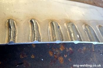

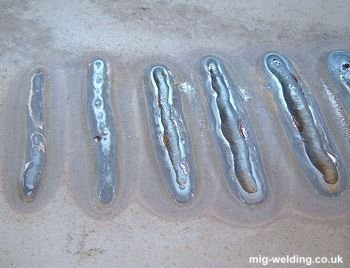

The sectioned sheet shows the effect of the increasing power settings more clearly. In the first two welds the weld builds up above the sheet, but doesn't penetrate through.
The third weld has build up on the top and bottom of the sheet. It is the best weld in the photo.
The welds to the right have more penetration below the sheet than above which shows the power setting is too high.
