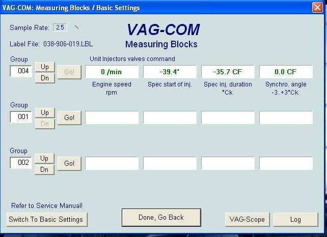

er det dette man mener med start timing på tdi pd? Sjekket på min tdi og dette fikk jeg med tenning på og motor av.
Noen som kan bekrefte om dette er riktig side på VagCom?
Fra Ross-Tech:
The timing in PD and CR engines is determined electronically by the ECU. There is neither a need nor an ability to check timing on the PD or CR engines using VAG-COM.. There are no graphs published for the simple reason that the timing is set using a dedicated VAG locking tool when changing the timing belt :-)
Fra forums.tdiclub.com:
You do not have to have a VCDS to check the timing on a PD, and the engine does control the timing.
What you can do is check that your cam is in time with your crank shaft. Basically you are checking your timing belt installation is proper. This is adequately done by using crank and cam locking pins during installation, if the belt is kept properly tensioned. But the check is easily done, and can flag belt stretching or other problems.
Go to measuring block 4, field 4, and check the value. It should be between -3 and +3, with zero being ideal.
If it gets more negative than zero, your cranking time gets longer. I keep mine between 0 and +0.5.
You adjust the cam sprocket to make this adjustment.
Og her er link til hvordan en justerer kam timing: http://forums.tdiclub.com/showthread.php?t=215202
Fra Ross-Tech:
Å blir ikke det verktøyet brukt kan det blir feil. Bruker som regel å gå veldig fint uten verktøy også, men meningne min var bare å gjøre folk oppmerksom på det om problemet har dukka opp etter at reima har blitt skiftet.
"Go to measuring block 4, field 4, and check the value. It should be between -3 and +3, with zero being ideal."
Er det ikke nettop dette bildet Glenn Ove viser i posten sin da?
Ser slik ut, og min er på 0 med motor av iallefall:)
