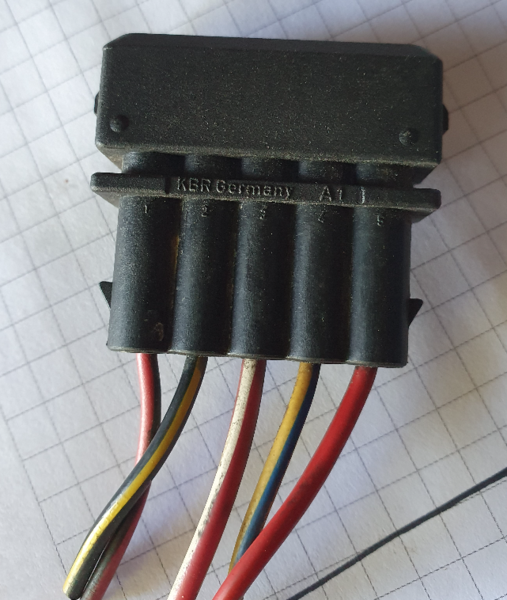

Trenger hjelp med denne. Denne skal vel mot digifant? denne kommer fra innsiden av bilen og er plassert ved kjølevesketanken
All info om oppkobling av digfant mottas med takk!

Hei,
noen år siden jeg hjalp et medlem med å konvertere sin bil fra digifant til megasquirt, men fant igjen denne informasjonen lagret på en harddisk:
The connector you're showing is where the Engine/ECU harness connects to the secondary engine harness that goes inside to the fuse panel.
-The red wire with white stripe is the o2 sensor heater power supply wire.
-The red wire with yellow stripe is the for the ground control side of the fuel pump relay. The ECU uses this wire to turn the fuel pump on and and off.
-The red wire with green stripe is the a starting signal (power) that just tells the ECU that the engine is actively cranking.
-The black wire with yellow stripe is the main ECU power supply. It normally comes from the ECU relay.
-The solid red wire is the fuel injector power supply, which is supposed to be on whenever the ECU relay is on.
